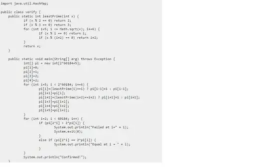

Here is java code that I used to verify it (adding an image only):
