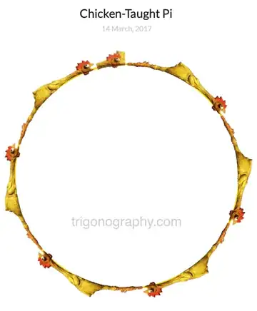

I got this idea from a colleague in grad school. It's one of my favorite lessons.
Since my original posting of this answer, I've created an animation that appears on my trigonography site. The animation itself is too big to post here, but a frame of it appears below.
Take a rubber chicken ---yes, a rubber chicken--- to a chalkboard.
  • Press its feet together firmly to the board, hold a piece of chalk in its beak, and use the chicken like a compass to draw a nice, big circle.
  • Mark a point on the circle you've drawn.
  • Press the chicken's feet together at that point, bend the chicken around the circle, and mark where its beak lands.
  • Do that step again. And again. And again. And again. And again. And ag--- oh, wait ... we can't do it again: we've run out of circle! Hmmmm ...
  • Fold the chicken in half. Then fold it again. Voila! The double-folded chicken just fits into the left-over space on the circle.
  • Consequently, a circle with a radius of $1$ rubber chicken has a circumference of about $6.25$ rubber chickens ... an estimate that's within half a percent of the actual value (namely, $2\pi$)!
  • Now note: There's nothing special about the rubber chicken. We could've used a rubber cat, or a rubber python, or a rubber earthworm, or a rubber Godzilla, or a rubber band that extends from one end of the galaxy to the other. No matter what we object we use for a radius, we can fit just-about six-and-a-quarter of them around the circumference.
This doesn't explain anything about the irrationality of $\pi$ or that kind of thing, but it's a lesson the kids will never forget. :)
