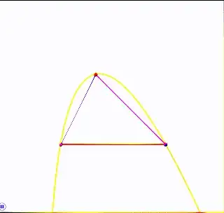

Illustrating a comment to OP's own answer.
Shown is an entire family of parabolas through three points, indicating that three points alone do not determine a parabola.
As mentioned in my comment, a conic in the coordinate plane has five characteristics: eccentricity, scale, orientation, $x$-location, $y$-location. Our interest in parabolas specifies a characteristic (eccentricity $=1$); the points account for three more characteristics; and the animation cycles through the aspects of the fifth (here, orientation).

Hi Blue, animation is so nice. What parabola equation do we have with variable orientation as parameter ? – Narasimham Apr 12 '16 at 15:59
1@Narasimham: I'm working on how to present the derivation, but if we have $A=(0,0)$, $B=(c,0)$, $C=(b \cos A, b\sin A)$, then the parabola through $A$, $B$, $C$ whose axis is parallel to the vector $u = (\cos\theta, \sin\theta)$ has this equation: $$\begin{align}0 &= x^2 \sin A \sin^2\theta - 2x y \sin A \sin \theta \cos\theta + y^2 \sin A \cos^2\theta \ &- x c \sin A \sin^2\theta + y \left(; - b \sin^2(A-\theta) + c \cos A \sin^2\theta ;\right)\end{align}$$ – Blue Apr 12 '16 at 18:33

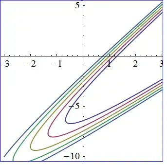

EDIT 1:
5 points for a conic. A parabola has $\epsilon=1, B^2 - 4 A C =0 $ that reduces number of constants/equations to 4.
$$ A x^2+ 2 \sqrt {A\,C} x y+C y^2+D x+E y= 1 $$
This can be cast into the form making $y$ subject of parabola equation :
$$ y = (a x + b) \pm \sqrt { c x + d }$$
If 3 constants are fixed, a single parameter family of parabolas is possible like in the example graphed :
$$ y = 2 x - 5 \pm \sqrt {3 x + 2 t} $$
Only 3 constants are not adequate to determine a general parabola .

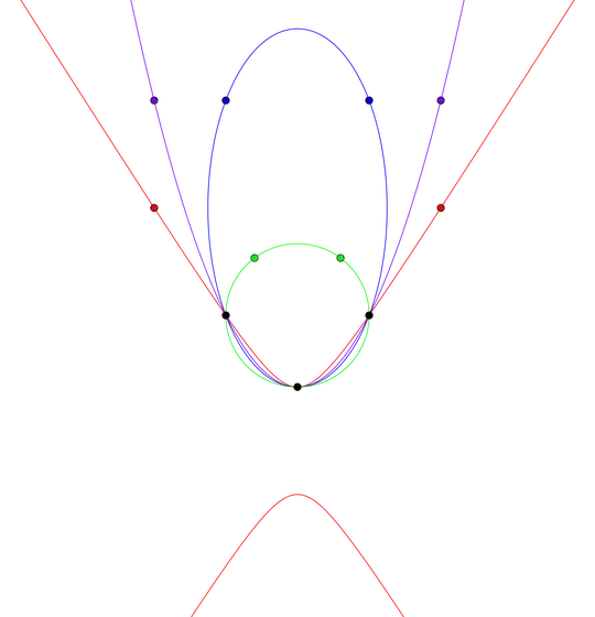

As you can see from the image below, if you are defining a conic, it requires five points to be known. The conics below all share three points (black), but need two more to define what they are.
If we trying to simply define a parabola, it only takes three points because we know it is a parabola, and it can't possibly be a ellipse or hyperbola -- because we decided we already that we are making a parabola!
