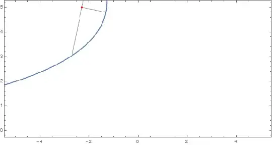

As I've shown in a previous answer, the focus of a parabola rolling on a straight line traces a catenary. Similarly, the directrix of the same rolling parabola will envelope another catenary, a reflection of the one being traced by the focus.
Here is a modern (as in done with the current version of Mathematica) version of the cartoon I did for that previous answer:
thus a parabola rolls
  • I really like your answer, but I accepted the answer of pjs36 over yours because that of pjs36 is more tied to physical reality (cannon balls, roads, etc.), whereas your answer is purely a geometrical result. I have upvoted your answer, however. –  Apr 07 '16 at 14:08
    That's certainly your choice to make, but then "trajectory" does not mean what you imply it means. – J. M. ain't a mathematician Apr 07 '16 at 14:10
