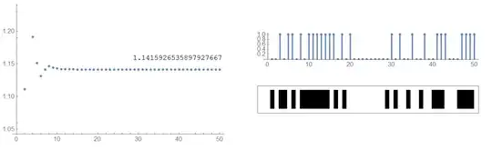

$$\pi-2=--+-++-+-+++++++-+-+---------+-+--+--+--+++---++++ \dots=1.141592653589793 \dots$$
Basically, $50$ terms of our expansion gave only $15$ correct decimal digits for $\pi$. But considering the expansion can be coded as binary, it's not so bad.

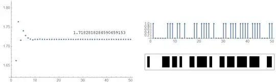

The convergence plot, and two binary plots for this $50$ terms can be seen below:
$$e-1=+-----+++-++-+---++-++++-+---++-+++-++++-++++---++ \dots=1.71828182845905 \dots$$

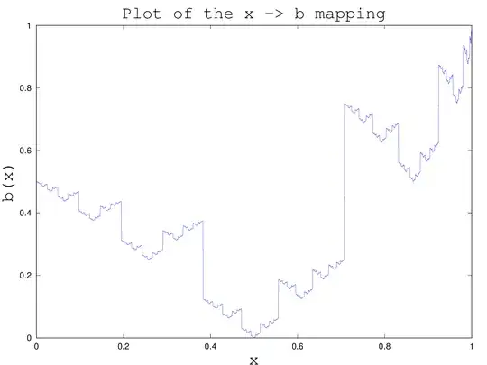

Peculiar observation
If we define a binary number $b = b_1b_2\cdots b_n$ with digits mapped to the symbols like this: $$b_k = \begin{cases}0 \text{ if } (-) \text{ at position } k\\1 \text{ if } (+) \text{ at position } k\end{cases}$$ Then if we run the algorithm proposed in the question, looping
x(k) = x(k-1)^2-2;
b(k) = (x(k)>0);
the vector b will get logical values corresponding to bits 1 and 0 of the binary number above and we can calculate it for the linear space of $x\in[0,1]$. If we do this we can then calculate each number as the scalar product $$[1/2,1/4,\cdots,1/2^k]b$$ and if we then plot it, it will look like
enter image description here Which is kind of a peculiar plot having a bit of a discontinuous and fractal structure. I think the largest discontinuity is around $x = \sqrt{1/2}$ but I have no theoretical explanation why..
edit as pointed out by Sangchul Lee this seems similar to Tent Map
