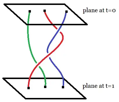

So what about $n>2$? In configuration space (which has $2n$ real dimensions, so is hard to visualize) a single point, a "configuration," represents $n$ distinct points in a plane (which is easy to visualize). And a path in configuration space represents each of the $n$ points in the plane having a path in and out of it.
Thus, imagine a continuum (indexed by $[0,1]$) of copies of $\Bbb C$ (resting flat) piled on top of each other. If one lets the altitude represent time, then the paths traced out between the points represent strings, and if one looks at this picture from the side one sees braid diagrams! Example:
$\hskip 1.3in$ braid diagram
Since we can choose our basepoint for $\pi_1$ to be anything, without loss of generality we may assume it is $\{1,2,\cdots,n\}\subset\Bbb C$ for the purpose of visualization. Tuples in $\Bbb C^n$ with nondistinct coordinates represent two strings intersecting at the same point, which is why wemust delete this subspace from $\Bbb C^n$: to prevent collisions.
A path in $\Bbb C^n$ ending where it started means each colored string above would have to go back to its original point, and this defines a pure braid. If we quotient by the action of $S_n$, we essentially allow the path in configuration space to go to any of the permuted configurations, which means the strings in the braid diagram can connect different dots.
