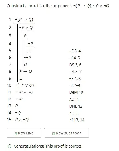

Consider the following proof in a Fitch-style proof checker:
Although you were able to reach line 10 in one move using equivalences it took lines 2-9 for me to derive the same result. What is important is that I was able to derive the result. What is useful to know is that one can convert from conditionals to disjunctions and negations if one has to.
Note that this subproof would have been shorter if I had something like "double negative introduction", but all I have is double negative elimination (DNE) which I used on line 13. That meant that I had to derive line 6 from a subproof on lines 4 and 5 rather than reference an inference rule.
Still, what is important is that I was able to derive those results. The natural deduction system is complete. It can derive every formula that is true.
Kevin Klement's JavaScript/PHP Fitch-style natural deduction proof editor and checker http://proofs.openlogicproject.org/
