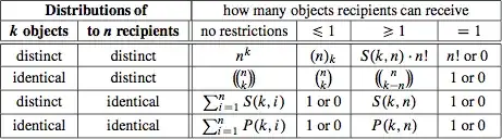

From Combinatorics: A Guided Tour
If you want to know how to say each:
$n^k$: n to the k
$n!$: n factorial
$(n)_k$: n falling k
$n \choose k$: n choose k
$\left(\! {n \choose k} \!\right)={{k+n-1} \choose k}$: n multi-choose k
$S(n,k)={n \brace k}$: n Stirling k
