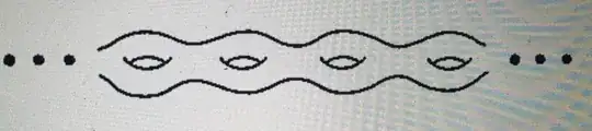

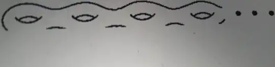

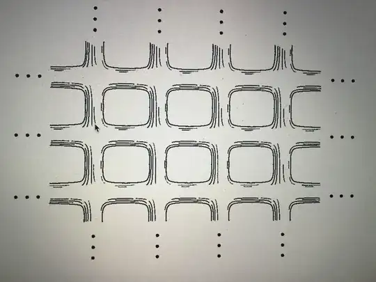

I want to prove that the infinite-holed torus and the infinite-jail cell window have one end but the doubly infinite-holed torus doesn't, my definition of one end is the following:
A locally compact (not compact) space $X$ has one end if for every compact $C \subset X$ there is a compact $K$ such that $C \subset K \subset X$ and $K^{c}$ is connected.
But the thing is that I don't know how to wave my hands here. Can someone help me with this issue?

Follow Andrew's suggestion: First, embed $X$ inside $\mathbb{R}^3$. Then, any compact $C \subset X$ is bounded in $\mathbb{R}^3$, so that you may find a large closed ball $B$ containing $C$. (For the infinite torus you also want to enlarge the ball so that it contains the entire "end" as well as $C$.) Finally take $K = B \cap X \supset C$.
The problem with the doubly infinite torus is that $K^c$ will always be disconnected for any compact $C$ such that $C^c$ is disconnected.
