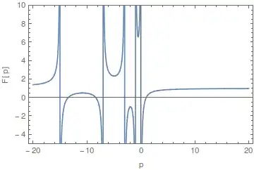

A plot of the solution F(p)
  • This function is a valid CDF between its highest zero and $\infty$, i.e. it is nondecreasing and approaches 1. However its highest zero does not equal $c_H$, and may be $>c_H$ (this happens when $K$ is large), in which case it is not a valid CDF within the region $p\in ]c_H,q_H]$.
