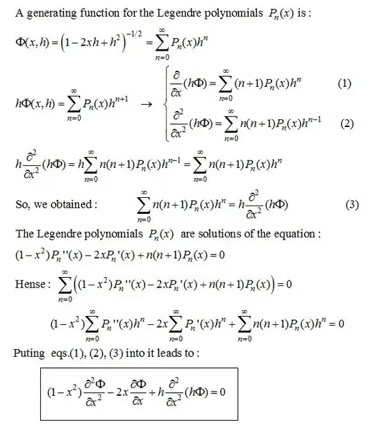

The simplest way is to start from the generating function definition :
