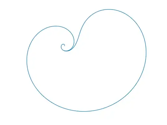

I can present an example problem with a complex fractional derivative. Consider the Cauchy pulse (Ref: S.L. Hahn, Hilbert Transforms in Signal Processing, Artech House, 1996)
$$\psi=\frac{1}{1-i\tau}$$
Differentiating $n$ times we obtain
$$\psi(\tau,n)=\psi^{(n)}(\tau)=\frac{d^n\psi}{d\tau^n}=\frac{i^nn!}{(1-i\tau)^n}=\frac{i^n\Gamma(n+1)}{(1-i\tau)^n}$$
And, of course, the Gamma function is our pathway to any fractional derivative. Now, insofar as $\tau \in (-\infty,\infty)$ we can make a change of variables so that $\tau=\text{tan}\theta,\ \theta\in [-\pi/2,\pi/2]$. Then
$$\frac{1}{(1-i\tau)^n}\to \frac{1}{(1-i\text{tan}\theta)^n}=\text{cos}^{n+1}\theta \ e^{i(n+1)\theta}$$
As an example, we plot the ${i^{3/2}}^{th}$ derivative of the Cauchy pulse [note that $i^{3/2}=\frac{\sqrt{2}}{2}(-1+i)$]. Clearly, we can create a infinite number of new plane curves in this manner.
For a more detailed description of the Cauchy pulse and related functions see The Apple of My i. This was my first foray into recreational mathematics five years ago.
