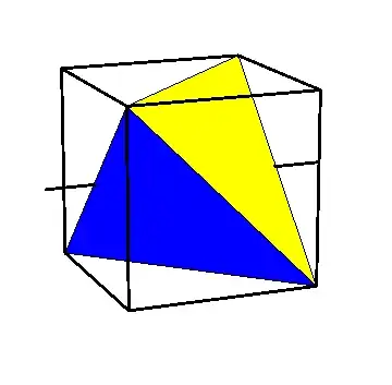

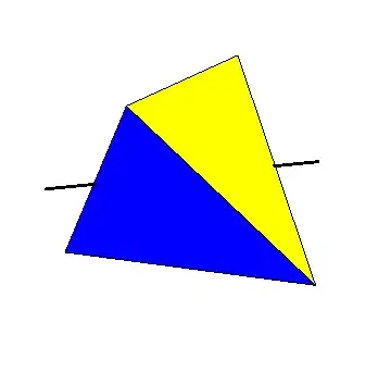

But what about $(12)(34)$, $(13)(24)$ and $(14)(23)$? How to get them?

One of them
Use different axes (connecting the midpoints of two opposite edges of the tetrahedron) to get the other products of two disjoint 2-cycles as 180 degree rotations.
Here is the same animation with the cube surrounding the tetrahedron shown as a wireframe. The axis of rotation joins the centers of two opposite faces of the cube

  • Sorry I didn't get neither the picture nor the explanation. For example consider (12)(34). In order to change change 1 and 2 with each other, there must be a 180-degree rotation in some axis that pass through the midpoint of 1 and 2 as well. Why this axis of rotation is the axis of rotation which interchange 3 and 4? –  Mar 19 '16 at 19:18
  • The axis of rotation connects the midpoints of 12 and 34. – Jyrki Lahtonen Mar 19 '16 at 19:22
    Another way of thinking about this is to view it as a rotation of the cube surrounding the tetrahedron (the 4 vertices of the tetrahedron are also vertices of the cube) – Jyrki Lahtonen Mar 19 '16 at 19:25
    It's brilliant! Thank you. Only thing that I struggle with is that "being a rigid shape is sufficient that after exchange of 1 and 2, and, 3 and 4 by one rigid axis the final configuration coincides with the original one"? –  Mar 19 '16 at 19:31
  • That's a good question. It should become clear that the said rotation is a symmetry, when I add the surrounding cube to the picture. Gimme 5-10 minutes. – Jyrki Lahtonen Mar 19 '16 at 19:33
  • in order to interchange 1 and 2, or, 3 and 4, the mentioned axis must be perpendicular to each of the lines joining 1 and 2, or, 3 and 4. I think that's enough. But I can't prove the perpendicularity. –  Mar 19 '16 at 19:47
  • @Liebe Those two lines are diagonals of two opposite faces of the surrounding cube. The axis is perpendicular to both of them, because the axis is perpendicular to both those faces. – Jyrki Lahtonen Mar 19 '16 at 19:49
  • Simply explained and perfect answer. Thank you very much indeed. :) –  Mar 19 '16 at 19:51
