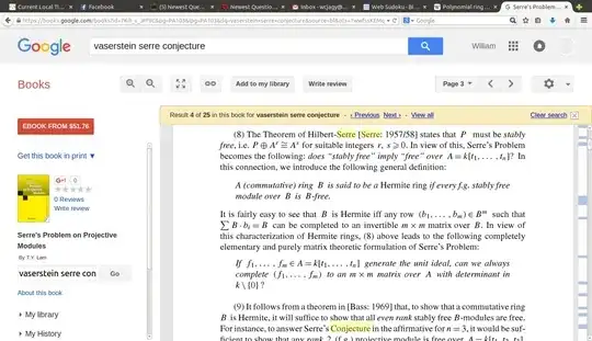

  • added jpeg from the Lam book to my answer – Will Jagy Mar 19 '16 at 04:45

This is on page 13 of Newman, Integral Matrices. The section is called Completion to a unimodular matrix. Your fact is Theorem II.1
In general, you can start with $k$ rows and complete with determinant $1,$ as long as certain determinants of submatrices have gcd $1.$ I will see if i can find that.
See also THEOREMS
And then Serre Quillen Suslin Vaserstein
In other words, all you need is Lang's Algebra. There is also a whole book on it by T.-Y. Lam.

  • @LeviathanTheEsper, see https://en.wikipedia.org/wiki/Quillen%E2%80%93Suslin_theorem – Will Jagy Mar 19 '16 at 04:13

  • Area, there is a simplified proof in Lang's Algebra; also a book on it by Lam. The conjecture goes back to Serre. https://en.wikipedia.org/wiki/Quillen%E2%80%93Suslin_theorem – Will Jagy Mar 19 '16 at 04:17
