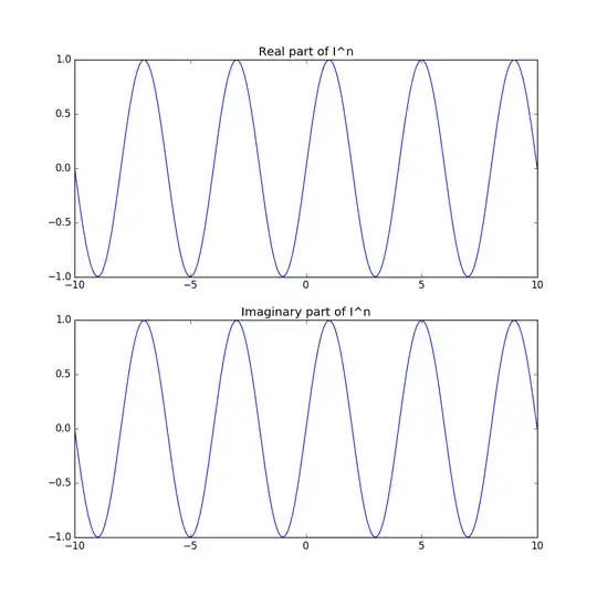

Today I was thinking about imaginary numbers and hypothesized the graph of $i^x$ would be sinusoidal based on the simple exponent rules of i. I think this can be explained with logarithms, which I've never studied in depth so cannot be sure.
I tried graphing real and imaginary parts of $i^x$ with sympy (a python symbolic maths package) and did end up with this sinusoidal curve.
I'm wondering if someone here can comment on this curve - if there is some formula involving a trigonometric function that is equal to $i^x$, how one would find the derivative of $i^x$, and any other related ideas. Also, links to relevant literature would also be great.

    I’d be happier if you defined precisely what $i^x$ is, for real $x$. Once you do, I think your answer will pop out at you. After all, $i^{1/2}$ will usually be understood as a square root of $i$, and there are two equally good candidates there. – Lubin Mar 16 '16 at 01:17
  • @theideasmith $i^x$ is not a well-defined function $\Bbb R\to \Bbb C$, namely because $$i=e^{2ki\pi+\frac\pi2i}$$ for any $k\in\Bbb Z$, but you can easily see that the maps $$x\mapsto e^{\frac\pi2ix}\ x\mapsto e^{2\pi ix+\frac\pi2ix}$$ are different: for instance, they take different values at $x=\frac12$ (and for almost all the non-integer values). –  Mar 16 '16 at 01:21
  • The same issue carries on to real and imaginary parts: $$\cos\left(2\pi x+\frac\pi2x\right)\ne \cos\left(\frac\pi2x\right)\quad\text{for almost every }x\in\Bbb R$$ –  Mar 16 '16 at 01:28
  • However, I think the thing you are using to run the calcs is assuming the notation $$i^x:= e^{\frac{\pi}{2}ix}=\cos\left(\frac\pi2x\right)+i\sin\left(\frac\pi2x\right)$$ ($x\in\Bbb R$) which should also explain quite clearly the graphics you get. –  Mar 16 '16 at 01:30
  • @G.Sassatelli can you recommend specifically what learning path I can take to really understand these issues? – theideasmith Mar 16 '16 at 01:37
$$ \begin{array}{c|r} x & i^x \\ \hline 0 & 1 \\ 1 & i \\ 2 & -1 \\ 3 & -i \\ 4 & 1 \\ 5 & i \\ 6 & -1 \\ 7 & -i \\ 8 & 1 \\ \vdots & \vdots \end{array} $$ It goes around in circles. If you want a well-behaved function extending this to $x\in\mathbb R$, you just need something that goes around in circles at that same rate, thus $$ x\mapsto \cos\left(\frac \pi 2 x\right) + i \sin\left( \frac \pi 2 x \right) = e^{i(\pi/2)x} = e^{i\pi x/2}. $$
    It might be instructive to mention that there are several branches of $i^x$ since $$i^x=e^{x\log(i)}=e^{i\pi x/2}e^{i 2n\pi x}$$ – Mark Viola Mar 16 '16 at 02:49
As the commentators have noted, a (probably better) way of writing the function you are interested in is $$f(x)=e^{\pi ix/2},$$ which should make sense if we know $i=e^{\pi i/2}$ and apply properties of exponents. It is likely that your calculator has interpreted $i^x$ in this way for you in making your graphs.
