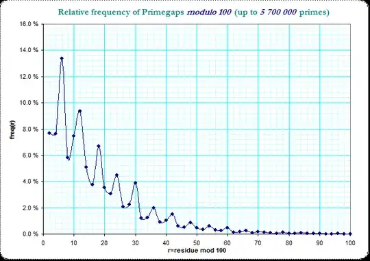

in logarithmic scale imglog

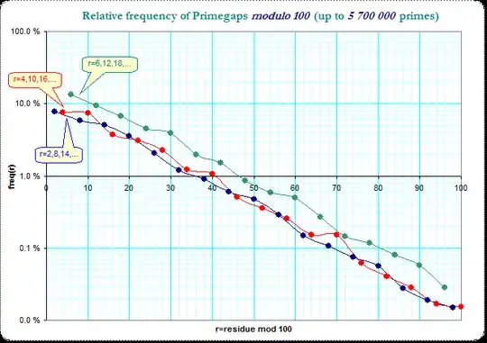

We see the clear logarithmic decrease of frequencies with a small jittering disturbance over the residue classes. It is also obvious, that the smaller primegaps dominate the larger ones, so that a "slot" which catches the primegaps of lengthes $2,12,22,...$ has more occurences than the "slot" which catches $8,18,28,...$ - just by the frequencies in the very first residue class. The original table of frequencies in the residue classes modulo 10 splits this into 16 combinations of pairs of 4 residue classes and the observed non-smoothness is due to that general jitter in the resdiue classes of the primegaps.

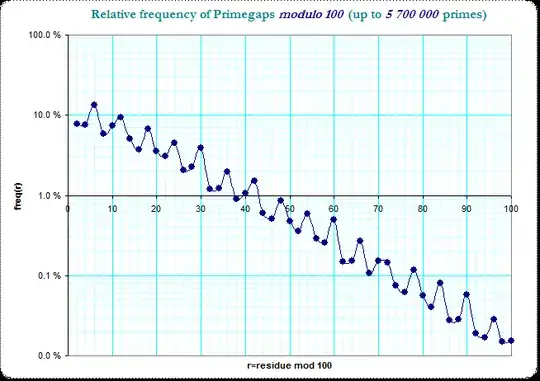

It might also be interesting to see that primegap-frequencies separated into three subclasses - :
That trisection shows the collected residue classes $6,12,18,...$ (the green line) as dominant over the two other collections and the two other collection change "priority" over the single residue classes.
The modulo-10-problem overlays that curves a bit and irons the variation a bit out and even makes it a bit less visible - but not completely: because the general distribution of residue classes in the primegaps has such a strong dominance in the small residue-classes. So I think that general distribution-characteristic explains that modulo-10 problem, however a bit less obvious...

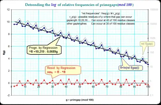

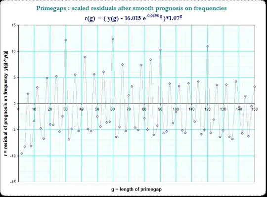

2. Further observations (update 2)
For further analysis of the remaining jitter in the previous image I've tried to de-trend the frequencies distribution of the primegaps (however now without modulo considerations!).
Here is what I got on base of 5 700 000 primes and the first 75 nonzero lenghtes g. The regression-formula was simply created by the Excel-spreadsheet: image_trend
De-trending means to compute the difference between the true frequencies $\small f(g)$ and the estimated ones; however, the frequency-residuals $\small r_0(g)=f(g) - 16.015 e^{-0.068 g }$ decrease in absolute value with the value of g. Heuristically I applied a further detrending function at the residuals $\small r_0(g)$ so that I got $\small r_1(g) = r_0(g) \cdot 1.07^g $ which look now much better de-trended.

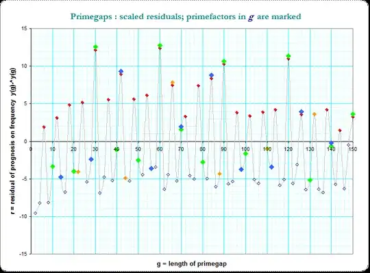

This is the plot of the residuals $\small r_1(g)$:
image_resid
Now we see that periodic occurences of peaks in steps of 6 and even some apparent overlay. Thus I marked the small primefactors $\small (3,5,7,11)$ in g and we see a strong hint for a additive composition due to that primefactors in $g$
image_resid_primefactors
The red dots mark that g divisible by 3, green dots that by 5, and we see, that at g which are divisible by both the frequency is even increased.
I've also tried a multiple regression using that small primefactors on that residuals, but this is still in process....

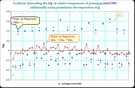

3. observations after Regression/Detrending (update 3)
Using multiple regression to detrend the frequencies of primegaps by their length g and additionally by the primefactors of g I got initially a strong surviving pattern with peaks for the primefactor 5. But those peaks could be explained by the observation, that (mod 100) there are 40 residues of primefactor p where the gaplength g=0 (mod 10) can occur, but only 30 residues where the other gaplengthes can occur.
Thus I computed the relative (logarithmized) frequencies as $\text{fl}(g)=\ln(f(g)/m_p(g))$ where $f(g)$ is the frequency of that gaplength, and $m_p(g)$ the number of possible residue classes of the (first) prime p (in the pair (p,q) ) at where the gaplengthes g can occur.
The first result is the following picture where only the general trend of decreasing of frequencies of larger gaps is detrended:
picture_regr_1
This computation gives a residue $\text{res}_0$ which is the relative (logarithmized) frequency after the length of the primegap is held constant (see the equation in the picture). The regular pattern of peaks at 5-steps in the earlier pictures is now practically removed.
However, there is still the pattern of 3-step which indicates the dominance of gaplength 6. I tried to remove now the primefactorization of g as additional predictors. I included marker variables for primefactors q from 3 to 29 into the multiple regression equation and the following picture shows the residues $\text{res}_1(g)$ after the systematic influence of the primefactorization of g is removed.
picture_regr_2
This picture has besides a soft long hill-like trend no more -for me- visible systematic pattern, which would indicate non-random influences.
(For me this is now enough, and I'll step out - but still curious whether there will come out more by someone else)
    +1 Gottfried: Good observations! I totally missed the other symmetries, though I did notice the $4.62,, 4.44,, 4.44,, 4.62$ when I highlighted them. – Tito Piezas III Mar 15 '16 at 14:48
    The lengths divisible by six are very strongly favored (in my plot of $\frac{\phi(n)}{n}$ those are the most prominent white lines). It looks like highly composite numbers are the most favorable distances between primes. In particular, products of two primes are avoided, which would disfavor small distances between primes in the same residue class. – Reikku Kulon Mar 20 '16 at 16:35
  • @Reikku : yes, the composite primegaps seem to be more frequent (see the red dots for divisibles by 6 - they are on top of the (rescaled) frequency list in the last image). What I was additionally trying was to find, whether there is some exact functional relation of the -scaled- frequencies and the primfactors in g (with or without multiplicity) - thus I tried multiple regression including primefactor markers. But my results are not yet convincing, at least not convincing me... I'll update my answer when I've more. – Gottfried Helms Mar 20 '16 at 20:54
