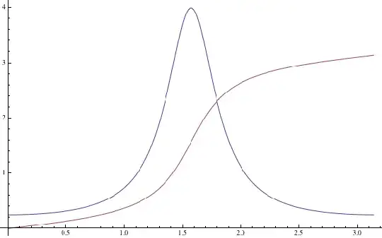

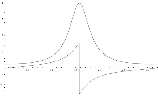

First, let us assume that $a, b > 0$ without loss of generality. Then in this regime, $f(x) = (a^2 \cos^2 x + b^2 \sin^2 x)^{-1}$ is clearly a well-defined function everywhere, and is periodic with period $\pi$. However, the antiderivative is not unique, and the particular choice of antiderivative $$F(x) = \frac{1}{ab} \tan^{-1} \left( \frac{b}{a} \tan x \right)$$ may not be continuous over a given interval. For example, if we choose the branch of $\tan^{-1}$ that restricts the range to lie in $(-\pi/2, \pi/2)$, then you get this picture for $a = 2$, $b = 0.5$:
As you can see, there is a jump discontinuity in the antiderivative at $x = \pi/2$ that could be rectified by choosing a different branch of the inverse tangent; e.g., we could choose $\tan^{-1}$ to have the range $[0,\pi)$. This fixes the discontinuity at $\pi/2$ so that a definite integral containing this point will not result in an incorrect evaluation.
In general, it is important when dealing with branches of multivalued functions to choose the branch appropriate to the interval or domain of integration, so as to avoid these problems.
