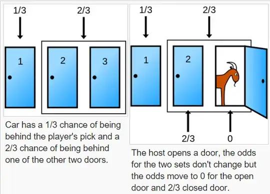

Let's say that they now begin to read the questions and in some cases they can deduce that one of the provided answers which was not the one that they picked is not correct (let's assume that there is no error in this deduction). In the scenario with the Monty Hall Problem, the probabilities did not change once the door was opened, they just shifted.
Taken from Wikipedia
By applying the same logic, the original selected answer has a 1/4 chance of being correct and the other three have a 3/4 chance of being correct, except that since one was deduced to be incorrect, the two remaining options have a 3/4 chance of being correct and so switching answers would increase the odds of being correct to $\frac{1}{2} * \frac{3}{4}$.
