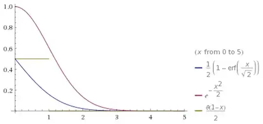

Examples of such $X$ include the standard Gaussian and Rademacher distributions. Both satisfy stronger tail bounds, as illustrated by the following plot. This makes me wonder whether stronger bounds hold for all such $X$.
