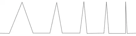

Here is a picture (not very accurate, I know), to see how to construct a counter-example:
$\qquad\qquad\qquad$enter image description here
The $n$-th triangle centered at $x=n$ have basis of length $1/n^2$. This is Friedrich Philipp's idea.

    If we want we can write the function as $$f(x) = \sum_{n=2}^\infty\chi_{[n-c_n,n]}\frac{(x-n+c_n)}{c_n} + \chi_{[n,n+c_n]}\frac{(n+c_n-x)}{c_n}$$ where $c_n = \frac{1}{n^2-1}$ and $\chi_A(x) = 1$ if $x\in A$ and $0$ otherwise. However I think this a good example of a situation where a picture is much better than an explicit formula. – Winther Mar 28 '16 at 05:08
  • I should have written "This is Friedrich Philipp's idea (in an above comment)", to be clearer. – Watson Jul 11 '17 at 12:35
