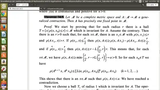

Then I was referring to the following book "Geometrical Methods of Non-Linear Analysis" by Zabreiko & Krasnoselskii which does the proof for the above. It proceeds as I did and then does something which I don't understand. In the sixth line, the authors say that "for each $x_0 \in T$... " and then reaches the contradiction. I don't understand this step at all.
enter image description here I think that I have to get hold of $ x \in M $ such that $ d (x, Tx) \lt a $. But I have no clue how to get hold of such $ x $. Even if I get a contradiction I am not able to show that the point in the intersection is the fixed point either.
