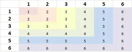

Now I want to consider $\Bbb{E}(3,k,2)$. In the previous case each value $i$ occurred $2i - 1$ number of times. Where did $2i - 1$ come from?
It looks like the frequency of occurrence is the difference of consecutive squares.
$$i^2 - (i-1)^2 = 2i - 1$$
This seems intuitive based on the image I provided. We can reason that in the case of $n = 3$, the frequency of occurrence will be the difference of consecutive cubes.
$$i^3 - (i-1)^3 = 3i^2 - 3i + 1$$

If $M$ is the maximum value on the $n$ dice thrown, then $\mathbb{P}(M\leq x)=(x/k)^n$ so that $\mathbb{E}(M)=\sum_{x=0}^{k-1} \left(1-\left({x\over k}\right)^n\right)=k-{1\over k^n}\sum_{x=0}^{k-1}x^n.$ Using Faulhaber's formula you can show that $$\sum_{x=0}^{k-1}x^n ={1\over n+1}\left[k^{n+1}-{1\over 2}(n+1)k^n+O(k^{n-1})\right]$$ and putting these together gives, as you expected, $$\mathbb{E}(M)={n\over n+1}\,k+{1\over 2}+O(1/k).$$
