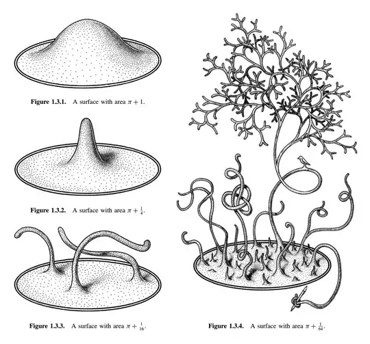

If $K_n$ is not connected, this is not true. One can take $K_n = \bigcup\limits_{i=0}^{2^n-1} [{i \over 2^n}, {i + 1/2 \over 2^n}]$. Then $\mathcal H^1(K_n) = 1/2$, but $K_n \to [0,1]$. Also, for $\mathcal H^k$, $k$ an integer greater than one, this fails spectacularly. See this picture from Frank Morgan's book: enter image description here
