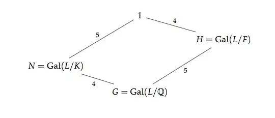

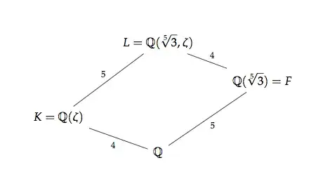

  • I might write a complete answer later, but here are some tips. 1) What is the degree of the normal closure over $\mathbb{Q}$? This will be the order of your Galois group. – Viktor Vaughn Mar 01 '16 at 23:20
  • There are many ways of describing a group, and listing all the elements with a multiplication table is one of the worst, unless the group is of very small order. In this case, I would recommend trying to find a presentation for the group by finding generators and then computing relations they satisfy. Anyway, I'm pretty sure in the end the Galois group is the Frobenius group of order $20$.
  • – Viktor Vaughn Mar 01 '16 at 23:23
