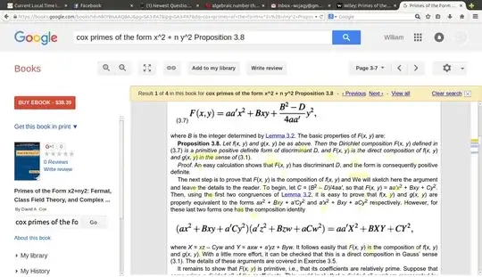

Dirichlet's methods tell us (page 49 in Cox, although the first edition has a typo, pasting corrected selection from second edition ) that $$ \left( 3 u^2 + 4 uv + 9 v^2 \right)^2 = 9 U^2 + 4 UV + 3 V^2, $$ where $$ U = u^2 - 3 v^2, \; \; \; V = 6uv + 4 v^2. $$
Another arrangement of the symbols $a,a',B,C$ tells us $$ \left( 9U^2 + 4 U V + 3 V^2 \right) \left(3 s^2 + 4 st + 9 t^2 \right) = 27 S^2 + 4 ST + T^2, $$ where $$ S = Us-Vt, \; \; \; T = 9Ut + 3Vs +4Vt. $$ Taking lower case $s=1,t=-1$ gives $$ 8 \left(3 U^2 + 4 UV + 9 V^2 \right) = 27 S^2 + 4 ST + T^2, $$ where $$ S = U +V, \; \; \; T = -9U + 3V - 4V = -9U -V. $$ Finally $$ (T+2S)^2 + 23 S^2 = 27 S^2 + 4 ST + T^2. $$
