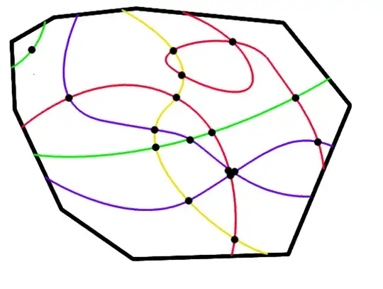

Can we not ignore multiplicities of overpasses, at least in the second formulation of the problem? We know that each polygon with a path through it requires at least one overpass. But if we have a polygon with any number of paths through it, such as: enter image description here

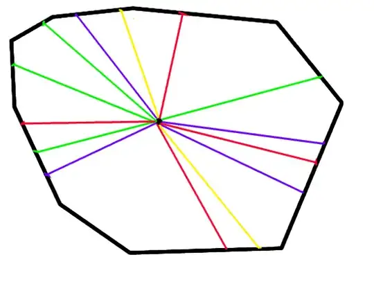

Can we not replace these path segments with a piecewise linear path the goes from one boundary point, which remains the same, to some central overpass, to another boundary point. This would give the following:
Which doesn't affect anything outside of the polygon and reduces all paths inside to one overpass. This gives an upper bound of $mn$.

    I think there's an implicit assumption that at most two roads can meet at any overpass. Even in the real world, each overpass intersects at most a constant number of roads. – JeffE Feb 05 '13 at 05:07
  • @JeffE I wholeheartedly agree with you. So this was more of a discussion of a fault in the problem statement than a true solution. – guest196883 Feb 05 '13 at 05:11
  • Yes, I had implicitly assumed that at most two roads meet at any overpass. @JeffE Oh god, I've never seen anything so horrible! Actually, I can't recall ever seeing more than two roads meet at an overpass, but that's probably because Kansas doesn't have many. – Alex Becker Feb 17 '13 at 21:48
