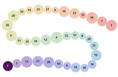

For which numbers $n$ can the sequence $1$ to $n$ be rearranged such that each pair of consecutive terms adds up to a perfect square?
Can this be done on the set of natural numbers as well? Integers? Rationals?

(Just to summarize things so people don't have to jump from MSE, MO, OEIS, SO.)
This is a rather interesting question, but there are two previous MSE posts that have already covered it. Post 1 (MSE) asks for which $n$ we can arrange {$1,2,\dots n$} so that the sum $S^k$ of every two adjacent numbers is a square (or $k=2$). A commenter pointed A090461 hence,
$$n = 15,16,17,23,25,26,27,\dots,\infty$$
so it is conjectured for all $n>24$. That, in turn, was inspired by Post 2 (MSE) which was the general case, but focused on sums $S^k$ for $k>2$. For $k=3$, the OP gave an example as $n=305$.
Post 3 (MO) gives an example for $k=4$ as $n=9641$. It was also a cyclic arrangement; that is, the first and last entries also have a sum $S^k$.
P.S. Re MYXMYX's question here if there is a cyclic arrangement for $n=35$ for squares, MJD found there are a whopping $17175$ possible arrangements, so chances are good. By the update below, OEIS says there are $57$ ways to do it.)
  • (Update.) Let $n$ have all adjacent pair-sums as $S^2$. Then the number of circular arrangements $m_c$ starting with $n=32$ is given by A071984 as, $$\begin{array}{|c|c|}\hline n&\text{# of};m_c\32&1\33&1\34&11\35&57\ \hline\end{array}$$ – Tito Piezas III Feb 29 '16 at 17:58
