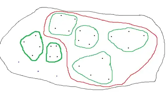

So let's look at base four because the Martian in the joke image has only four fingers while we have ten.
Very logically in his world he will form packs of four, then bundles of packs of four, and so on. For example , enter image description here $$(\color{red}1:\color{green}2:\color{blue}3)_{four}=\color{red}1\times four^2+\color{green}2\times four^1+\color{blue}3\times four^0$$
To count, in particular the four stones in the image, the Martian only needs four digits $0,1,2$ and $3$. When he sees a package, very logically, he says: "$1$ package" and writes $$10$$ He's never heard of $4$ because he doesn't really need $4$. Hence his question: "what is base four?"
