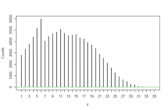

This seems to 'a random sum of random numbers': $Y = \sum_{i=1}^N D_i,$ where $N$ is found by rolling a fair die and, independently the $D_i$ are also found by rolling fair dice. Then standard formulas are $E(Y) = E(N)E(D)$ and $V(Y) = E(N)V(D) + V(N)[E(D)]^2,$ which can be proved by conditioning methods as in another hint.
A simple simulation in R of 100,000 such sums gives the following numerical and graphical results, which you can compare with your analytic answer:
 m = 10^5;  y = numeric(m)
 for (i in 1:m) {
    n = sample(1:6, 1)
    y[i] = sum(sample(1:6, n, repl=T)) }
 mean(y);  var(y)
 ## 12.23903  # approx E(Y) = 3.5(3.5) = 12.25
 ## 46.13508  # approx V(Y)
The simulated PDF is 'lumpier' than I guessed, but several runs of the simulation gave similar results.
