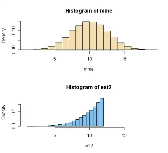

It is not difficult to find the PDFs of these two estimators and thus to derive these relationships analytically (see this Q & A), but the following simple simulation (using the sampling method) in R provides a preview of the results (for $n = 5$ and $\theta = 10$).
Notice that the distribution of the MME is roughly normal after averaging only five uniform observations. Even though the second estimator is less variable, the mode of its PDF lies to the right of $\theta = 10.$
 m = 10^5;  n = 5;  th = 10
 x = runif(m*n, 0, th)
 DTA = matrix(x, nrow=m)  # each row is sample of size n
 a = rowMeans(DTA)        # vector of m means
 b = apply(DTA, 1, max)   # vector of m maximums
 mme = 2*a;  mean(mme);  sd(mme)
 ## 10.01064              # approx. of E(MME) = 10 (unbiased)
 ## 2.588815              # approx. of SE(MME)
 est2 = ((n+1)/n)*b;  mean(est2);  sd(est2)
 ## 10.00017              # approx. of E(EST2) = 10 (unbiased)
 ## 1.69188               # indicates SE(EST2) < SE(MME)
