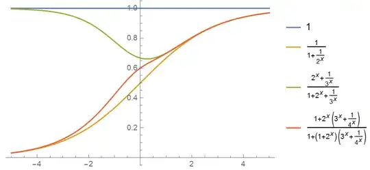

Here are the first few approximations, based on truncating the continued fraction:
$$\begin{align*} f_1(s)&=1\\ f_2(s)&=\frac{1}{1+2^{-s}}\\ f_3(s)&=\frac{2^s+3^{-s}}{1+2^s+3^{-s}}\\ f_4(s)&=\frac{1+2^s(3^s+4^{-s})}{1+(1+2^s)(3^s+4^{-s})} \end{align*}$$
Defining (thanks to vrugtehagel for his helpful comment):
$$f(s)=\lim_{n \rightarrow \infty} f_n(s)$$
CF zeta approx

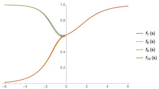

Using recurrence relations for continued fractions, I was able to get approximants for $f(s)$ of any order. The branching point near $s=-1$ is easy to see.
some approximants

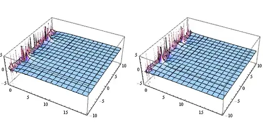

For fun, I decided to implement this function for complex arguments in Mathematica, and plot its real and imaginary parts. Here's the picture I got:
real and imaginary parts for a "Dirichlet continued fraction"
That pole fence jives with the OP's observation that the function is only sensible for $\Re s > -1$.
