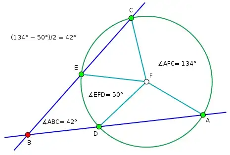

Let the vertex of an angle $ABC$ be located outside a circle and let the sides of the angle intersect equal chords $AD$ and $CE$ with the circle. Prove that the angle $ABC$ is equal to the half the difference of the angles subtended by the chords $AC$ and $DE$ at the center.

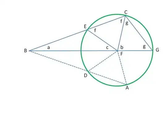

Triangles $FDA$ and $FCE$ are mutual images by the orthogonal symmetry with respect to the internal line bissector $(L)$ of angle $(EF,ED)$. As straight lines $ED$ and $EF$ make the same angle wrt to $(L)$, their intersection point, $B$, is on $(L)$.
This symmetry with respect to $BF$ allows to restrict our reasoning to triangle $BCG$ (where $G$ is the intersection of line $BF$ with the circle which is the farthest from $B$).
The following proof is "à la Euclid", by ''angle chasing''.
Let us give names to the following (unsigned) angles:
a = angle FBE, b = angle GFC, c = angle EFB,
f = angle FEC = angle ECF (because triangle FCE is isosceles)
g = angle FGC = angle FCG (because triangle FGC is isosceles as well).
Thus, we have the following relationships:
In triangle $EFC$: $ \ 2f+(\pi-(b+c))=\pi \ $. Thus $ \ f=\frac{b+c}{2} \ \ (1)$.
In triangle $FGC$: $ \ 2g=\pi-b \ \ \ (2)$.
In triangle $BGC$: $ \ a+f+2g=\pi \ \ \ (3)$
Substracting (3) - (2): $ \ a+f=b \ \ \ (4)$
Taking (1) into account, one gets
$$a = \frac{b-c}{2}$$
which is equivalent to the desired relationship.

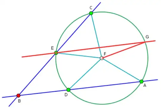

Construct the line through $E$ parallel to $AD$, intersecting the circle at $G$:
I assume you already have the theorem about the arc subtended by an inscribed angle, so $$ \angle CEG = \frac12 \angle CFG. $$ The triangles $\triangle AFD$ and $\triangle EFG$ are isoceles, so $\angle ADF = \angle DAF$ and $\angle GEF = \angle EGF$. Can you use those facts to show that $ \angle DFE = \angle AFG? $
Can you see now how to show that $$ \angle ABC = \frac12 (\angle AFC - \angle DFE), $$ which is what you need to prove?
