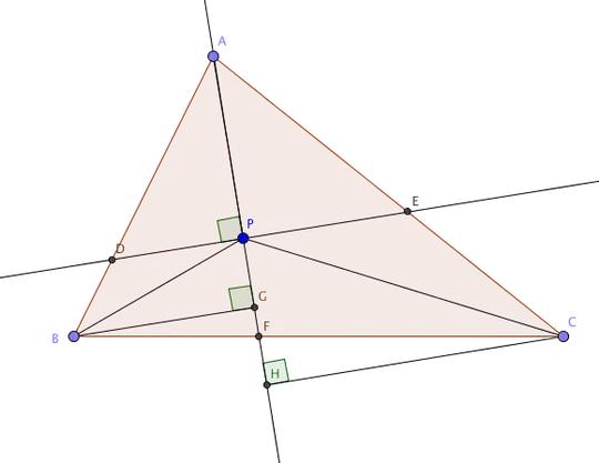

Since $P$ is inside $\triangle ABC$, at least two among $\angle APB$, $\angle BPC$, and $\angle CPA$ are larger than or equal to $90^\circ$. Suppose that $\angle APB\ge 90^\circ, \angle CPA\ge 90^\circ$. We then have the following picture:
Thus $$2AP\le AD+AE,$$ and $$\begin{aligned}BP+CP&\le (BD+\color{blue}{DP})+(\color{red}{PE}+CE)\\ &\le BD+ \color{blue}{BG} + \color{red}{CH} + CE\\ &\le BD + \color{blue}{BF} + \color{red}{CF} + CE\\ &= BD + BC + CE. \end{aligned}$$ The inequality follows.
Quang Hoang
  • 16,174
