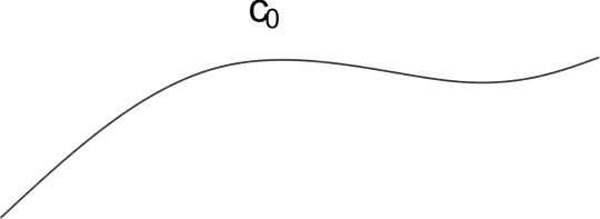

I'm surprised noone presented a drawing. A homotopy (between paths) can be naively represented as follows.
Suppose we have a path $c_0$ in space. Like this:

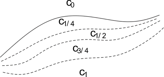

We now move it around, indexing its movement on the subscript. For instance,
Making this a continuous process, we get a function $G:I \rightarrow \mathcal{F}(I, Y); \quad s \mapsto c_s$, which induces in a clear manner a function $F: I \times I \rightarrow Y$ by $(s,t) \mapsto c_s(t)$.
A homotopy between maps is simply not restricting ourselves to paths. We consider the maps we want to deform to be maps $f: X \rightarrow Y$, and we get a function $G: I \rightarrow \mathcal{F}(X, Y)$ which induces $F:X \times I \rightarrow Y$ in the same way.
Aloizio Macedo
