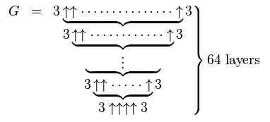

I found that Graham's number is :
So, can we say that it is equal to $3^x$ with $x$ is a power tower of 63 3's?

Now, Graham's number is defined as follows.
Notice the sequence
$G_0=4$ , $G_{n+1}=3\uparrow^{G(n)}3 $ for all $n\ge 0$
Then Graham's number is $G_{64}$.
Already $G_1=3\uparrow^4 3=3\uparrow \uparrow \uparrow\uparrow 3$ is so large that its magnitude cannot be comprehended. $G_2$ already has $G_1$ up-arrows, $G_3$ has $G_2$ up-arrows and so on.

I wrote an article here describing the progression. Here is the progression the way I understand it:
$$ 3\uparrow3 = 3^3 = 27 $$
$$ 3\uparrow\uparrow3 = 3\uparrow3\uparrow3 = 3^{3^3} = 7,625,597,484,987 $$
$$ 3\uparrow\uparrow\uparrow3 = 3\uparrow\uparrow3\uparrow\uparrow3 = 3\uparrow\uparrow(7,625,597,484,987) $$
Just to give you an idea of how big this is:
$$ \left.\begin{aligned} 3^{3^{3^{3^{⋰^{3}}}}} \end{aligned}\right\} \text{ height = 7,625,597,484,987} $$
Now we can define G1:
$$ 3\uparrow\uparrow\uparrow\uparrow3 = 3\uparrow\uparrow\uparrow3\uparrow\uparrow\uparrow3 = 3\uparrow\uparrow\uparrow(3\uparrow\uparrow(7,625,597,484,987)) $$
Now we can use the result in G1 to define G2:
$$ G2 = \underbrace{3\uparrow\uparrow ... \uparrow\uparrow 3}_{G1 \text{ up arrows}} $$
$$ G3 = \underbrace{3\uparrow\uparrow ... \uparrow\uparrow 3}_{G2 \text{ up arrows}} $$
$$ G4 = \underbrace{3\uparrow\uparrow ... \uparrow\uparrow 3}_{G3 \text{ up arrows}} $$
This keeps going until you get to:
$$ G64 = \underbrace{3\uparrow\uparrow ... \uparrow\uparrow 3}_{G63 \text{ up arrows}} $$
And that's Graham's number. It's a HUGE number.
