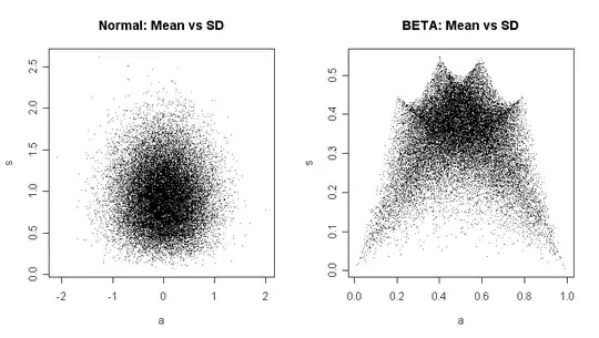

Illustration of independence of $\bar X$ and $S$ for normal, but not for nonnormal data: In each of the panels below 30,000 samples of size 5 are simulated, standard normal on the left and $Beta(.5, .5)$ on the right. In both cases, sample correlations are consistent with $\rho = 0$ (by symmetry). For normal data, $\bar X$ and $S$ are independent, and for beta data, they are obviously not. (The figure at right illustrates that a 5-D hypercube has been 'squashed' onto two dimensions. $Beta(.5,.5)$ puts most of its probability near corners, edges and (hyper)faces, images of some of these, after 'squashing', are discernible.)

 par(mfrow=c(1,2))
  m = 30000;  n = 5
   DTA = matrix(rnorm(m*n), nrow=m)  # each row a sample of size n
   a = rowMeans(DTA);  s = apply(DTA, 1, sd)  # sample mean and sd
   cor(a,s)
   ## -0.0066071
   plot(a, s, pch=".", main="Normal: Mean vs SD")
  m = 30000;  n = 5
   DTA = matrix(rbeta(m*n, .5, .5), nrow=m)  # non-normal data
   cor(a,s)
   ## -0.005415171
   plot(a, s, pch=".", main="BETA: Mean vs SD")
 par(mfrow=c(1,1))
