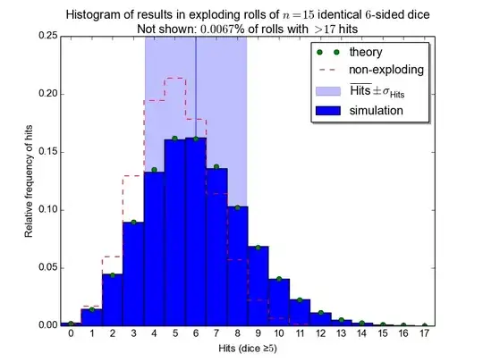

Here is a graph from a simulation (html) that illustrates the whole thing:
Comparison between exploding and non-exploding dice pools
