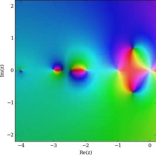

I will provide a heuristic method to conclude that yes, such values exist, using a domain coloring visual argument. A domain coloring applies a color to each point in the complex plane based solely on its polar angle --- i.e. write $a+bi=Re^{i\theta}$ and we assign the colors based on $\theta$ (the $R$ decides brightness, typically).

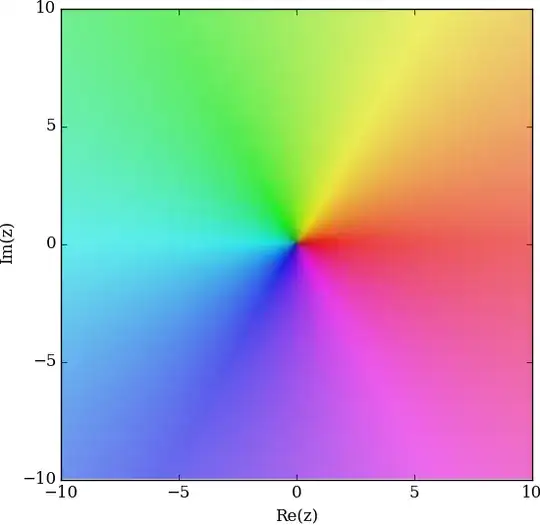

If I apply the (Python, mpmath) domain coloring algorithm to the identity function $f(z)=z$ I get the following image:
domain coloring of the identity function.
The important thing about this image is that you notice the positive $x$-axis is colored red --- clockwise from red we move towards yellow and counterclockwise from red we get magenta. If we were to continuously go from magenta towards yellow in a clockwise direction, we must pass through the reddish area (the center of which colors the positive real numbers).

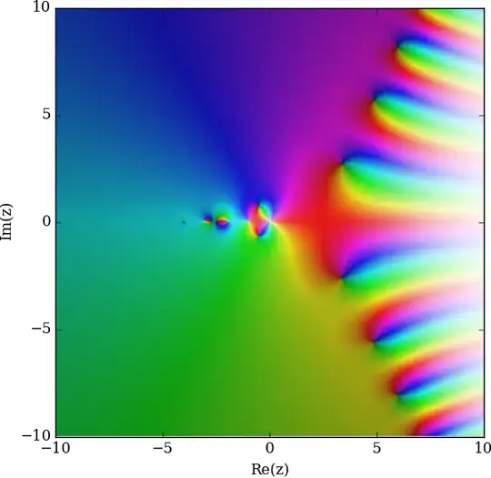

Now I will apply a domain coloring to your function $f(z)=\dfrac{\Gamma(z)+1}{z}$:
Notice in this image there are many "fingerlike" structures on the right. As Joanpemo noted, many values where $z \in \mathbb{R}$ yield real values (and hence are colored red in the image). Where else could $f$ be real?
Since $f$ is the sum and quotient of functions continuous on $\mathbb{C} \setminus \{0,-1,-2,\ldots\}$, we know that the function $f$ is continuous near the fingerlike structures and our image shows magenta --> red --> yellow color transitions (i.e. argument transitions from negative to positive) of $f(z)$ near the fingerlike structures.

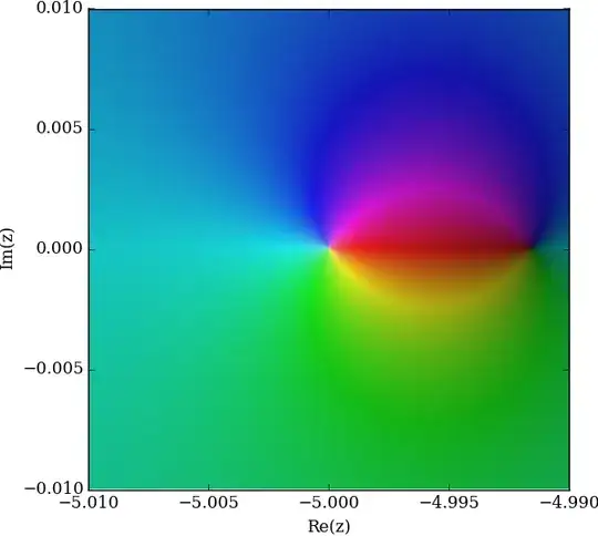

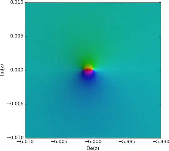

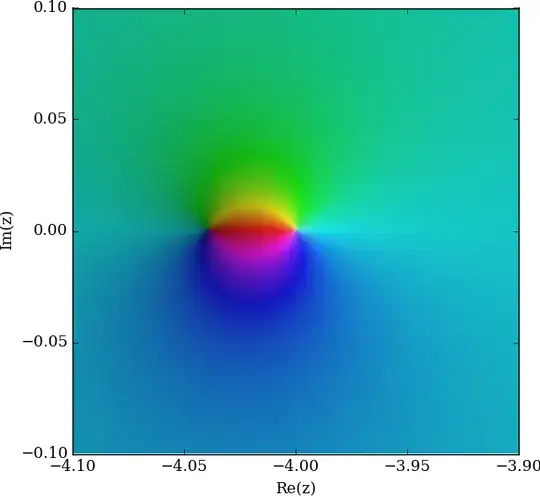

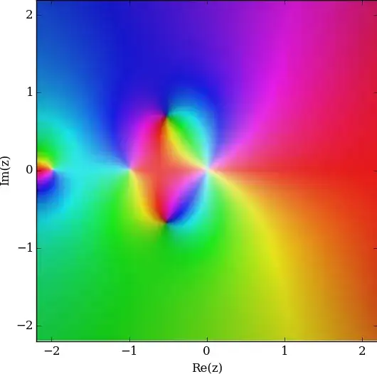

It also appears that there is a sequence of strange areas going left along the $x$-axis near each nonpositive integer. These structures come from the fact that $\Gamma$ has poles at such points. Here's some zoomed in images of those places:
zoomed in near -1 zoomed in near -2 zoomed in near -4 zoomed in near -5 zoomed in near -6
To make these images just change XMIN, XMAX, et al to desired values:
#!/usr/bin/python
import numpy as np
from mpmath import *
cplot(lambda x: (gamma(x)+1)/x,[XMIN,XMAX],[YMIN,YMAX],points=50000,verbose=True)
plt.savefig('FILENAME.png')

  • Okay, that makes sense, logically, and with @mercio's reasoning makes a good case for the existence of such points. The next question, naturally, is what the pattern for the real outputs is, and if there is a regularity to it that which can be modeled algebraically. (Beyond just the negative integers, there also appear to be reddish areas for Re(z)>0, the "fingerlike" structures in your coloring chart). – KR136 Feb 07 '16 at 19:39
