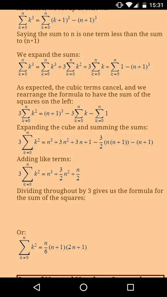

Here's how you do it! I've attached a picture I found on the internet since typing it takes time. This is a general approach that works for the sum of the $k^{th}$ power of n consecutive integers for all possible values of n. Hope it helps :)
spandan madan
  • 615
  • 11
    please use Latex instead of including the picture. I know that it "takes time" but this way the answer will remain available also when the link to the image will fail. – Ant Feb 07 '16 at 10:10
  • Had access to my phone only and couldn't type on latex on this. I thought its more important to post the answer and help out someone who needs help. I would really appreciate if you didn't penalize me negatively by down rating a correct answer in the interest of people coming to the question :) – spandan madan Feb 07 '16 at 10:11
  • I will gladly upvote as soon as you type that in Latex :) My point is that stackexchange is useful because things can be found quickly and have a good formatting; it's not like this solution does not exists anywhere else on the web or can't be found using google. This place is great because you find well formatted comprehensive answer, while this is hard to look at :-) – Ant Feb 07 '16 at 10:26
