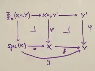

To get a canonical isomorphism $\Phi_x (X\times_Y Y')\cong \Phi_y (Y)$, note that $\Phi_x (X\times_Y Y') = \text{Spec}(K)\times_X (X\times_Y Y')$ and $\Phi_y (Y') = \text{Spec}(K)\times_Y Y'$ where $X\xleftarrow{x}\text{Spec}(K)\xrightarrow{y} Y$ are the $K$-points. Then since $f\circ x = y$, we have a commutative diagram where the two inner squares are pullbacks:
Diagram
Then from the pullback pasting lemma (see the section "pasting of pullbacks") the outer rectangle is a pullback diagram and so it follows that $\Phi_x (X\times_Y Y')$ has the UMP of the fibre product $\text{Spec}(K)\times_Y Y' = \Phi_y (Y)$, so must be isomorphic.
