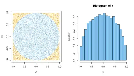

Here is an illustration using simulation of the case in which the points are uniformly distributed within the unit disk.
I generate 50,000 points in the square with vertices at $(-1,-1)$ and $(1,1)$ and discard those outside the circle. Then look at a histogram of the $x$-coordinates of the remaining 39,236 points (within the circle), which gives a pretty good idea what the density function looks like.
Analytically, you can treat the joint distribution of $x$ and $y$ as a uniform distribution on the unit circle and integrate out $y$ to get the marginal distribution on $x$. This should not be a difficult integration problem. (The integrand is a constant; the main information is in the limits of the integrals.)
 B = 50000;  xs = runif(B, -1, 1);  ys = runif(B, -1, 1)
 cond = (xs^2 + ys^2 <= 1);  sum(cond)
 ## 39236
 x = xs[cond]; y = ys[cond]
 par(mfrow=c(1,2))
   plot(xs, ys, pch=".", col="orange")
     points(x, y, pch=".", col="skyblue2")
   hist(x, prob=T, col="skyblue2")
 par(mfrow=c(1,1))

  • Notice that the arcsine distribution in @Did's Comment (for the circumference) has modes at each end--sometimes said to be 'bathtub shaped'. Anyhow, very much different from the distribution of my Answer (for the disk). The interpretation really does matter. – BruceET Jan 25 '16 at 21:40
