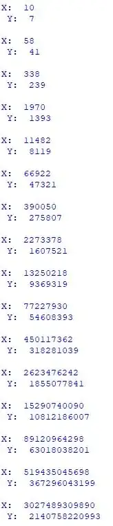

Let's say $\alpha_n$ and $\beta_n$ the $n$-solution of the equation $x^2 - 2y^2 = 2$. We have: $$\left\{\begin{matrix} \alpha_0 = 2 \\\beta_0 = 1 \end{matrix}\right. \land \left\{\begin{matrix} \alpha_1 = 10 \\\beta_1 = 7 \end{matrix}\right. \land \left\{\begin{matrix} \alpha_2 = 58 \\\beta_2 = 41 \end{matrix}\right.$$
From here, you can deduce the recoursive relation: $$\left\{\begin{matrix} \alpha_{n} = 3\alpha_{n-1}+4\beta_{n-1} \\\beta_{n} = 2\alpha_{n-1}+3\beta_{n-1} \end{matrix}\right.$$
This is the list of the values of $\alpha_n$ and $\beta_n$:
