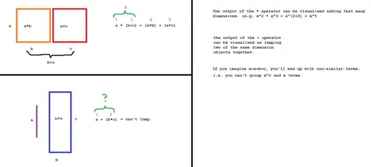

My way of interpreting the distributive law in an image:
The reason why people get annoyed with stuff like this is because they see the operations $+$ and $\times$ as symbols, not actual processes.
Standard index laws when using $\times$ allows us to relate multiplication with dimensions.
Standard addition laws regarding 'like terms' means we can't just simplify two entities from these 'separate' dimensions.
From image: "The output of the * operator can be visualised by adding dimensions (as per the index laws, x^2 * x^3 = x^5" "The output of the + operator can be visualised as lumping two of the same dimension objects together." "If you imagine x=a=b=c and apply the distributive law, you'll end up with non-similar terms. i.e. you can't group x^2 and x terms"
  • You shouldn't post answers (or questions for that matter) as images. Among other reasons, this makes it very hard to search for them and (almost) impossible to read them for visually impaired people. Images are perfectly fine as a support for an answer, though. Could you please crop the two images and type out the rest of the answer? – A.P. Jan 22 '16 at 14:48
    Sorry, will do. I just joined SE when I posted my answer – Dretland Leigh Jan 24 '16 at 23:54
