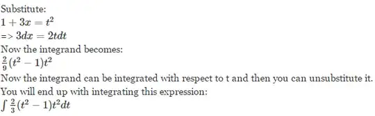

I've google for something and found this (here):
My problem is that according to the book, integration by substitution is based on the chain rule and hence:
$$\int f(g(x))g'(x)dx =F(g(x))+C\tag{1}$$
If I understood correctly, Apostol instructs to rewrite the function to be integrated on the form $f(g(x))g'(x)$ and then use $(1)$. My problem is that I don't see the form $f(g(x))g'(x)$ in the answer given by the link/image I provided, so I'm starting to think that the form $f(g(x))g'(x)$ may be something a little more complicated than I previously thought.

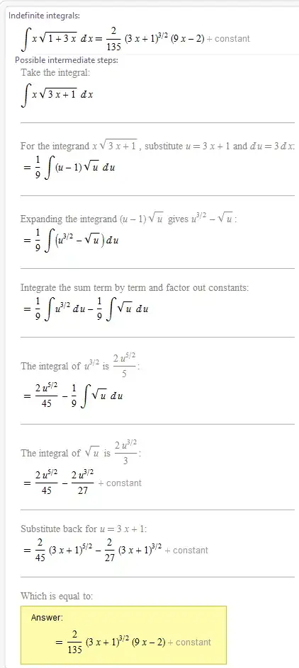

I have also tried to obtain a step-by-step solution with Mathematica/Wolfram Alpha. This elucidated a little more of what I was thinking:
Here, after making the appropriate substitutions, I also fail to see the form $f(g(x))g'(x)$ but there is an important point: It seems that the substitutions must be made in a way that if you substitute back, that is, if you put the $3x+1$ in the place of $u$ and $3$ in place of $du$, then after the expansion, it should become the expression you started with. This seems to be quite broader and vaguer than finding the form $f(g(x))g'(x)$, but it seems more honest (considering what I know at the moment). So, perhaps It's my stupidness, but where is the form $f(g(x))g'(x)$ in both these integration processes?
