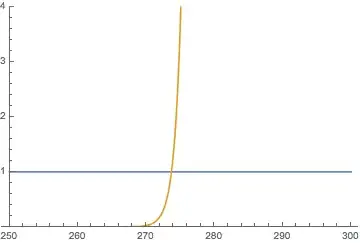

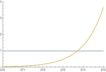

Plotting $\Gamma(n)/100^n$ tells us that the inequality is true for $n\geq 274$ :
Mathematica graphics
