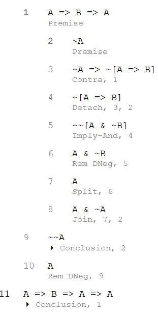

Using form of natural deduction in which implication is left associative:
