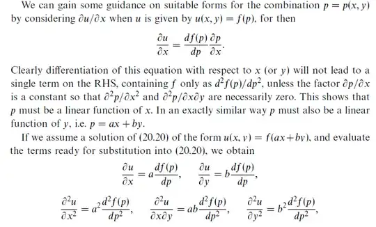

$\color{red}{\text{For some more context here is an image of the book source:}}$

Neither you nor the book are wrong. The book just takes the calculation a step further: $$ \frac{\partial}{\partial x}\left(a\frac{df}{dp}\right) =a\frac{\partial}{\partial x}\left(\frac{df}{dp}\right). $$ Treating $df/dp$ as a function $g(p) = \frac{df}{dp}(p)$, we apply the same reasoning you initially applied to $f$ to obtain $$ \frac{\partial}{\partial x}\left(\frac{df}{dp}\right) = \frac{\partial}{\partial x}g(p) = \frac{dg}{dp}\frac{\partial p}{\partial x} = a\frac{d^2f}{dp^2}. $$ Putting this back into the first equation, $$ \frac{\partial}{\partial x}\left(a\frac{df}{dp}\right) = a^2\frac{d^2f}{dp^2}. $$
