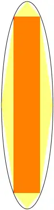

Consider the yellow and orange convex figures, which have the same bounding ellipsoid but different bounded ellipsoids.
Therefore, given just the bounding ellipsoid you cannot determine the bounded ellipsoid. (Nor vice versa.) You must know the figure $K$.
A better, limiting, example: Suppose $K$ is an ellipsoid. Then the bounding ellipsoid and the bounded ellipsoid are the same!
