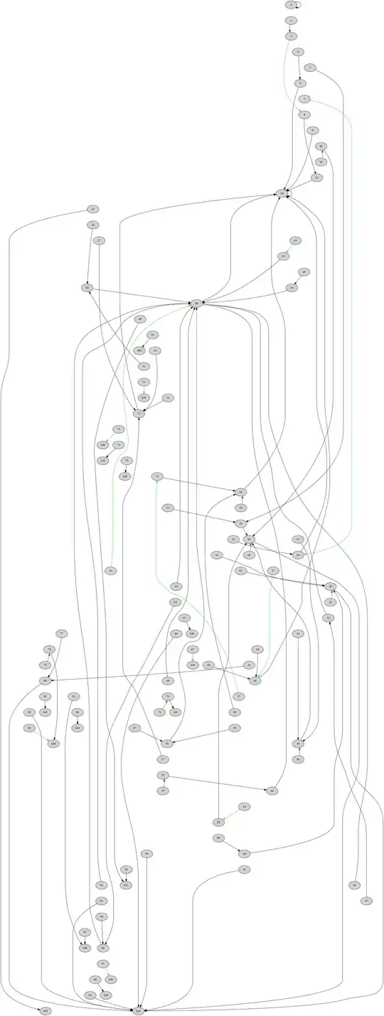

Addendum: Below is the graph $n \rightarrow \pi(n)$ including the fist $100$ numbers showing the rules $1\sim3$. Rule $1$: $\color{red}{Red}$, Rule $2$: $\color{blue}{Blue}$, Rule $3$: $\color{green}{Green}$ (click to widen).
