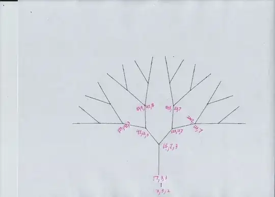

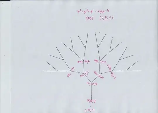

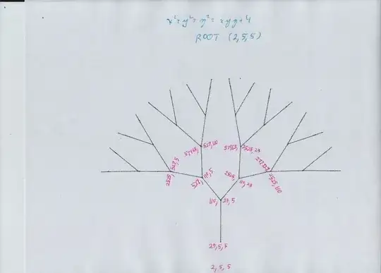

It is unusual that the solutions are gathered into an infinite number of trees, each with root solution $(2,t,t)$ as observed in another answer. This leads to a second "singular" solution $(t^2 - 2, t, t).$ After that we get triples with distinct elements. I did a small portion of the tree with root $(2,3,3).$
Travel within the tree is accomplished by three transformations: given a solution $(x,y,z)$ we get three other solutions $$ (yz - x,y,z), $$ $$ (x, zx - y, z )$$ $$ (x,y,xy -z). $$ If anyone of these is done twice in a row, all that happens is a return to the beginning triple. For the vast majority of solutions, one of the transformations reduces $x+y+z,$ so that a careful choice of transformations eventually gets us to a root $(2,t,t).$ ALSO: any of the transformations make no change to $\gcd(x,y,z).$ Given that the root element is $(2,t,t),$ we get $\gcd(x,y,z)= 1$ when $t \geq 3$ is odd, but $\gcd(x,y,z)= 2$ when $t \geq 4$ is even.
